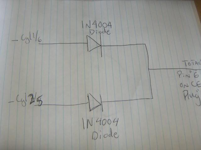

ka var pievienot mk2 tahometru uz vr6 motoru :? :?:

varam slegt pats jau atradu ka

Post by guntels » 24.08.2012, 22:24
google dara brinumu :D
tikai tagat jaatrod sadas diodes
