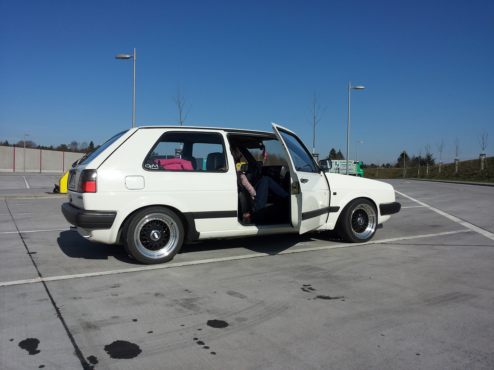

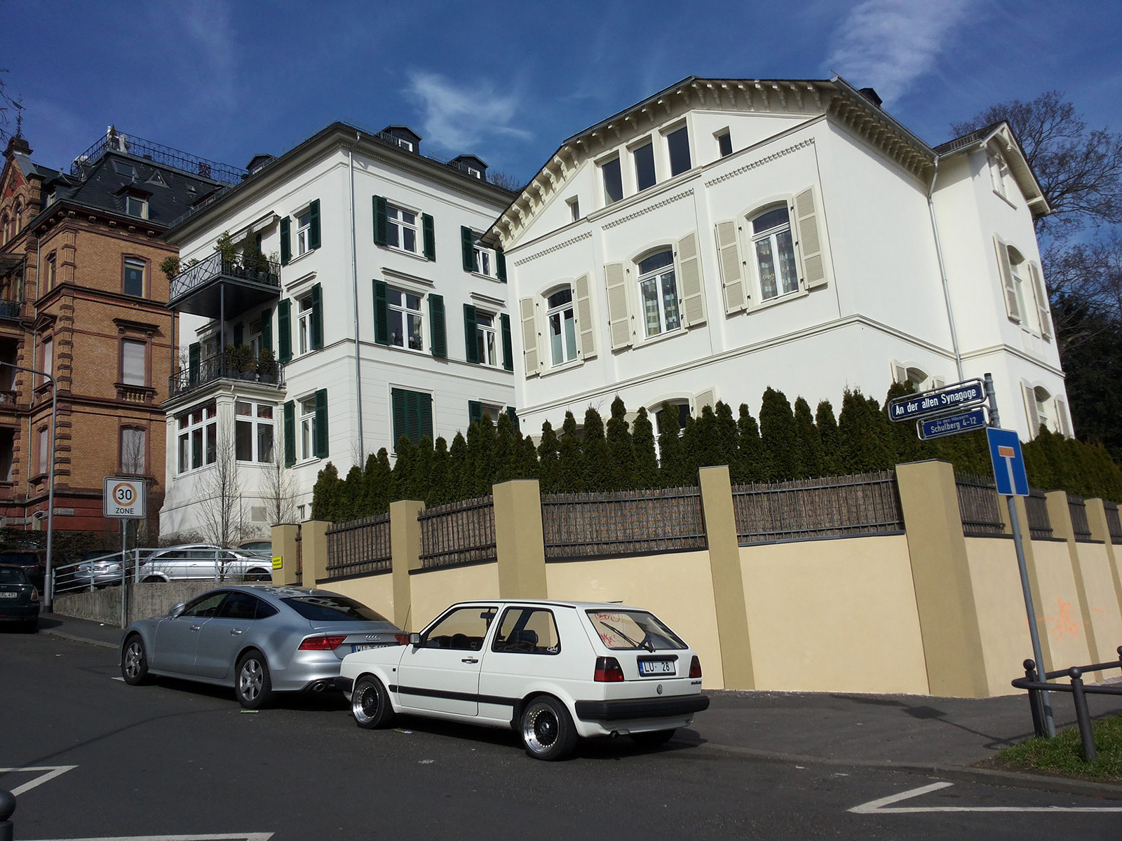

Post by Marchs » 11.03.2015, 22:03
he he, tā viš i. Ekonomisks auto, jo nelec. :lol:
p.s. random

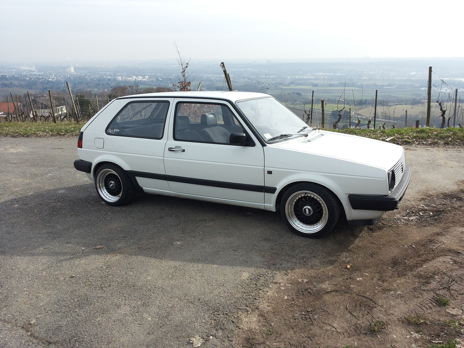

p.s. random bilde no dusošā gulbja ibio :lol:
